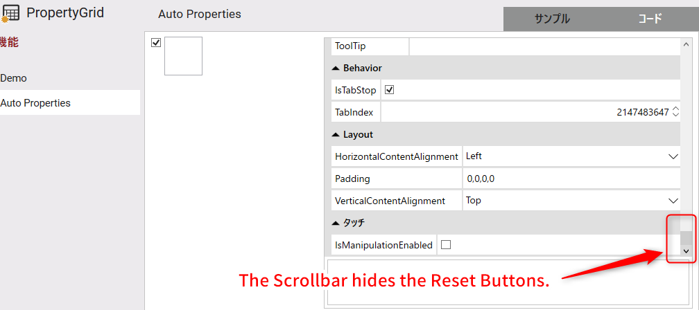

.NET5 PropertyGrid's Scrollbar hides the reset buttons
Posted by: info on 24 October 2021, 7:55 pm EST
    Posted 24 October 2021, 7:55 pm EST - Updated 4 October 2022, 8:36 am EST
    .NET5 PropertyGrid
    The scrollbar hides the reset buttons.
    How to change the stye?
  • Posted 26 October 2021, 3:35 am EST
    Thank you for providing the snapshot.
    This behavior seems like a bug. So that, we have escalated it to the devs. We will get back to you once we have any update.[Internal Tracking Id: C1XAML-28247]
