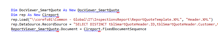

  • Posted 19 September 2017, 10:41 am EST
    Error on this line…
    Dim ReportViewer_SmartQuote As New ReportViewer_SmartQuote
    Type 'ReportViewer_SmartQuote ’ is not defined
    Image attached…
    Apologies for incorrect code in my last post. The code should be as follows :
    Dim DocViewer_SmartQuote As New C1DocumentViewer
    Dim rep As New C1Report
    rep.Load(FileName, ReportName)
    rep.DataSource.RecordSource = query
    DocViewer_SmartQuote…Document = rep.FixedDocumentSequence
    Moreover, I also observe error when defining C1Report. You need to add the missing references in the code :
    Imports C1.C1Report
    Mohita

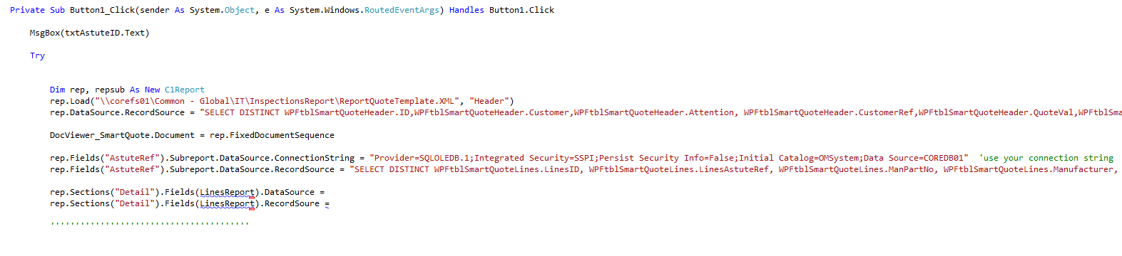

    Hi Mohita,
    Sadly I cannot post the application or data source.
    Please see image attached. Pleasue also note that the ‘Header’ and ‘LinesReport’ are stored in the same location.
    Dean
    As far my understanding of the issue goes, after seeing the screen-shot, it seems that the ‘Header’ and ‘LinesReport’ are two reports in the same definition file ie. ReportQuouteTemplate.xml
    Next, the ‘Header’ is the main report and the ‘LinesReport’ is the subreport added in the mainreport’s detail section with FieldName, say, ‘SubRepField’.
    In this case, if you wish to change the subreport’s datasource and recordosurce, you will have to use the following code :
    rep.Sections(“Detail”).Fields(“SubRepField”).Datasource
    rep.Sections(“Detail”).Fields(“SubRepField”).RecordSource
    Hope it solves your problem. Let us know if you still face any problems. Also, I would request you to share your sample application (along with the report xml and it’s datasource) with us. You may replace the actual data with some dummy values and then share the same with us.
    Mohita
