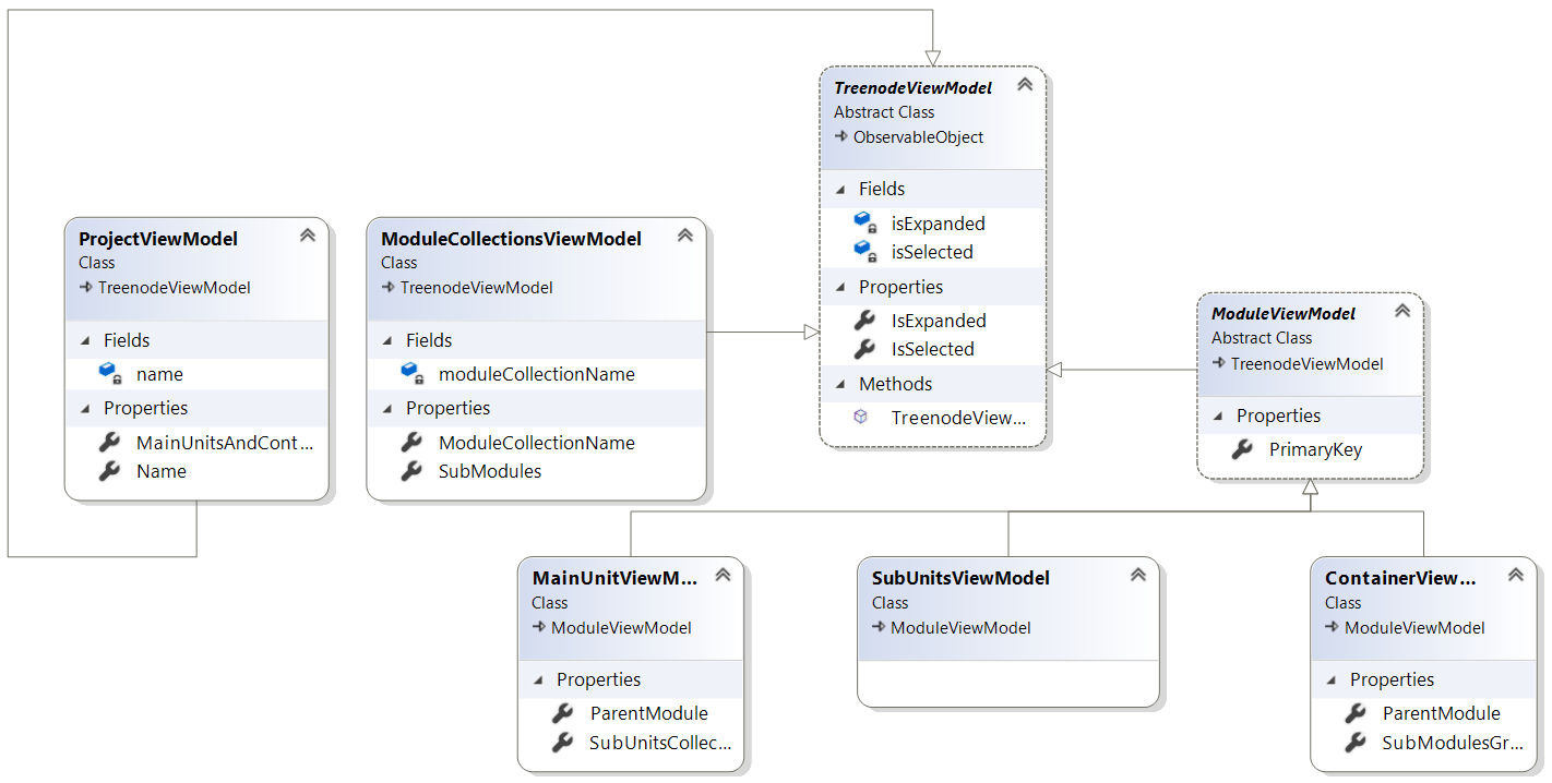

    We are working on a functionality wherein we need to populate a tree structure dynamically in a Treeview.
    We could do this with regular WPF Treeview and HierarchicalDataTemplate.

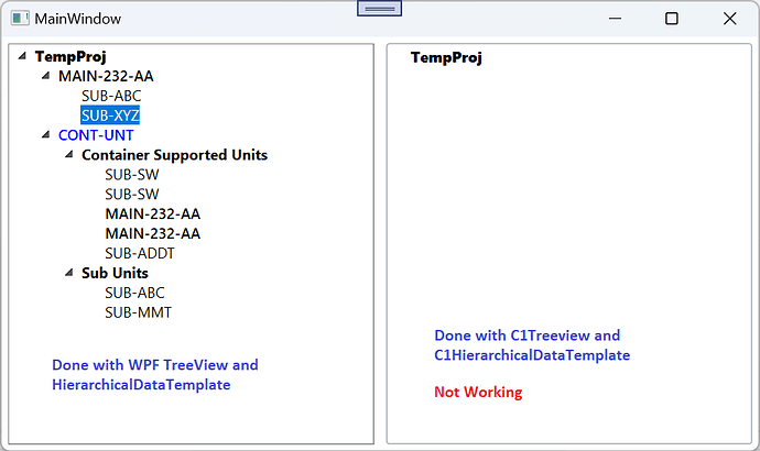

    However, when we tried to do the same with C1Treeview and C1HierarchicalDataTemplate, it is not working. (Ref File: Screenshot.jpg)

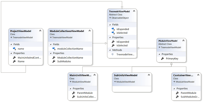

    The DataModel used is as shown in the attachment : DataModel.png
    Sharing also the sample application wherein WPF and C1 Treeview is used to populate the tree structure.
    Treeview-Query-App.zip
    Request your support for the same.

    Is there any way to disable the selection of group nodes?
    For example: in the attached screenshot, I want to disable the selection of nodes “Container Supported Units” and “Sub Units”
  • Posted 16 September 2023, 10:11 am EST
    Hi Mayur,
    You can handle C1TreeView’s SelectionChanged event to disable selection of C1TreeViewItems having ModuleCollectionsViewModel type object as its DataContext. Please refer to the following lines of code for the same:
    private void treeView_SelectionChanged(object sender, SelectionChangedEventArgs e)
        var selectedNode = treeView.SelectedItem as C1TreeViewItem;
        if(selectedNode != null && selectedNode.DataContext != null &&
        selectedNode.DataContext.GetType() == typeof(ModuleCollectionsViewModel))
            selectedNode.IsSelected = false;
    Kindly to the attached sample for full implementation. (See TreeViewBindingHierarchy_Mod.zip)
