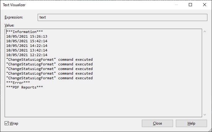

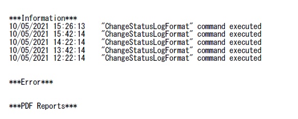

    I am extracting text from PDF documents (which are created using C1PdfDocument) by using GcPdfDocument.
    The PDF documents contain data with ‘\t\r’. However, I am not receiving the formatting as it is when read using GcPdfDocument.
    Please let me know how I can read the text line by line from the PDF document.
    Attaching screenshots for reference. (One screenshot of PDF Document[A.jpg] and one screenshot of the data extracted from PDF document[B.jpg])

  • Posted 5 October 2021, 11:26 pm EST
    Hi Nitin,
    I am extracting text from PDF documents by using GcPdfDocument.
    The following is the code:
    GcPdfDocument doc = new GcPdfDocument();
    FileStream fs = new FileStream(filename, FileMode.Open, FileAccess.Read);
    doc.Load(fs);
                string text = string.Empty;
                for (int pages = 0; pages < doc.Pages.Count; pages++)
                    text = text + doc.Pages[pages].GetText();
    Additional Info if necessary: I have already created those PDF documents by using C1PdfDocument.

  • Posted 6 October 2021, 2:23 am EST
    Hi
    Thank you for your reply.
    I am sharing the PDF file. (SampleLog.pdf)
    The following is the code to generate PDF:
