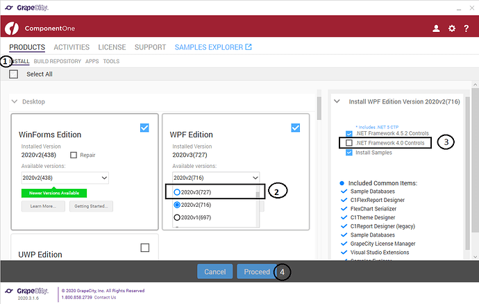

    Hi Joseph,
    You can use ComponentOneControlPanel for upgrading to the latest C1 build.
    https://www.grapecity.com/componentone/download
    1. Navigate to Products > Install.
    2. Select version ‘2020v3(727)’ in Available versions combobox (WPF Edition).
    3. Check the ‘.NET Framework 4.0 Controls’ checkbox.
    4. Click Proceed.
    For more information regarding ComponentOneControlPanel. Please refer here:
    https://www.grapecity.com/blogs/welcome-to-componentone-controlpanel
