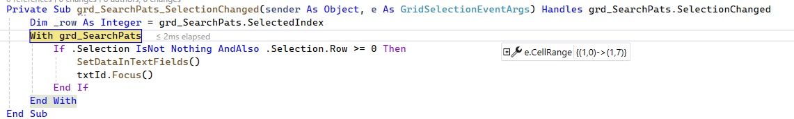

    I have an issue in WPF flexgrid SelectionChanged event.
    e.cellrange gives me row =1 but the selectedindex is 0.
    What could be the reason?
