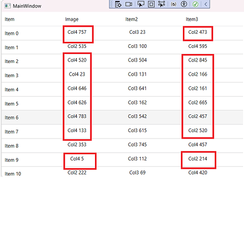

    I have several columns, My requirement for setting Image is not specific to certain columns.
    I need to set some alert Image next to the text for specific cells only depending on conditions.

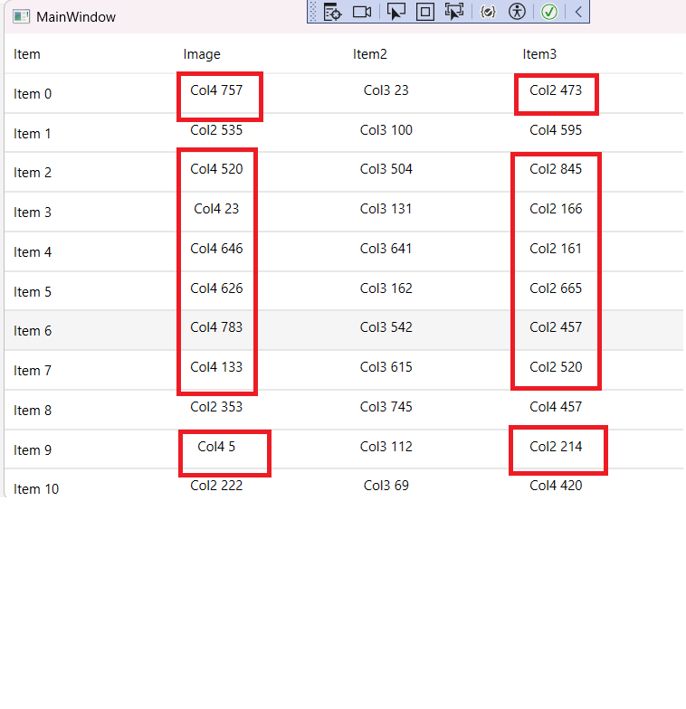

    To display text and image in the same cell, you need to create a custom CellTemplate using a TextBlock and an Image. Then, use the CreateCellContent method to set the text and image dynamically at runtime.
    Please refer to the updated sample project for reference - ImageConditional_Updated.zip
